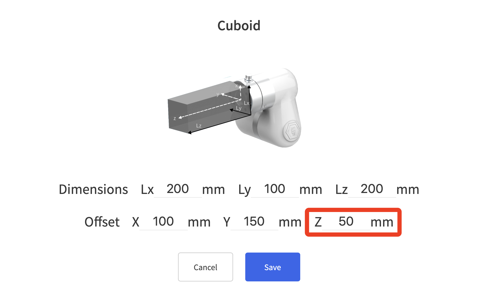

V2.7.0 New Feature ​
Live Control - End Collision Model Offset ​
Feature Description
  • Used to set the Z-direction offset of a custom end collision model relative to the tool coordinate system, for adjusting the position of the collision model.
  • After setting the offset, the effect is as follows:

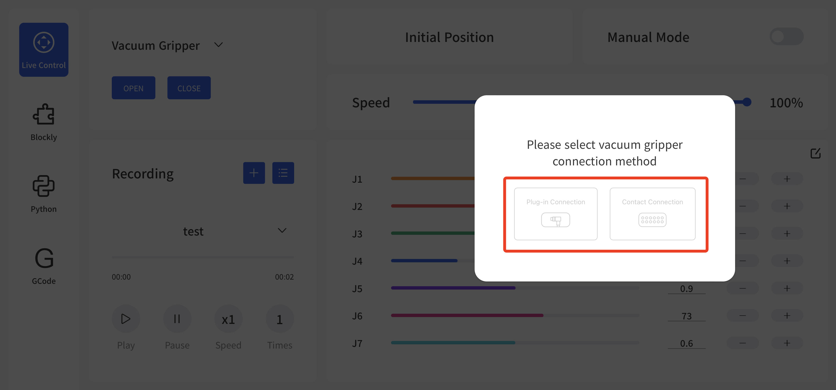

Live Control - End-effector - Vacuum Gripper ​
Feature Description
  • Added connection options: plug-in connection, contact connection

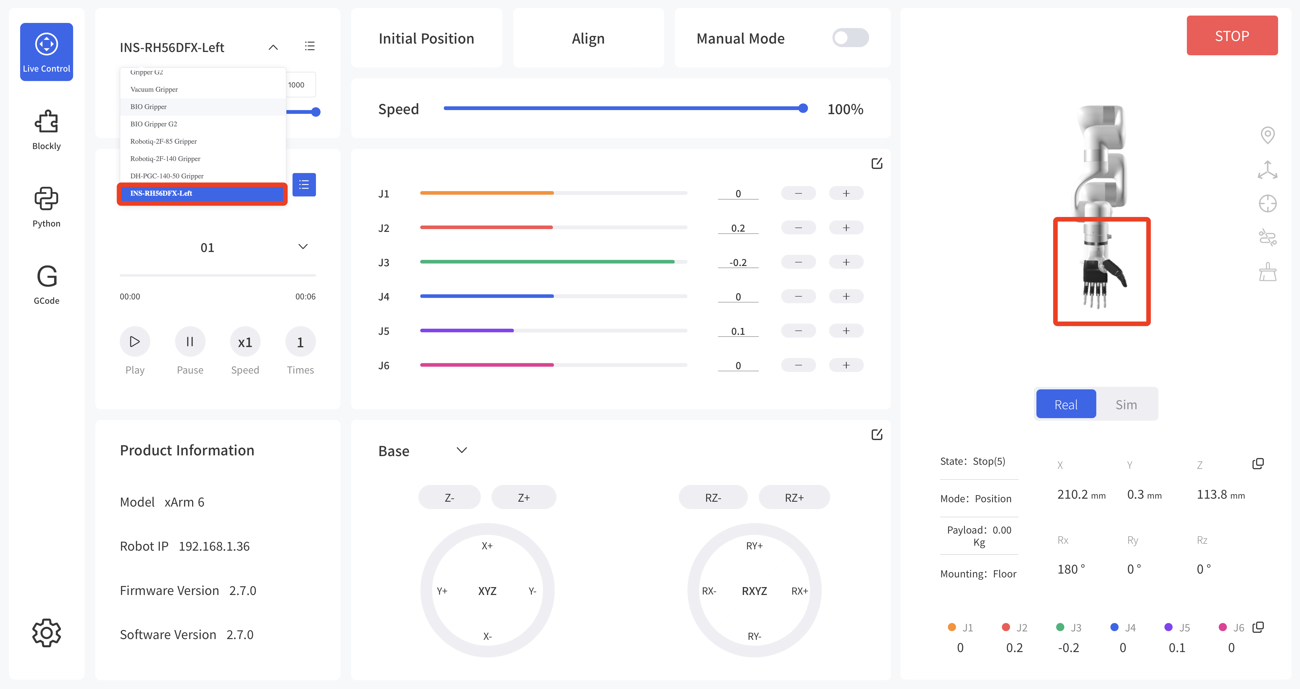

Live Control - End-effector Models ​
Feature Description
  • Compatible with UFACTORY Gripper G2, RH56DFX dexterous hand and DH-PGC-140-50 gripper. Supports control and adding self-collision models.

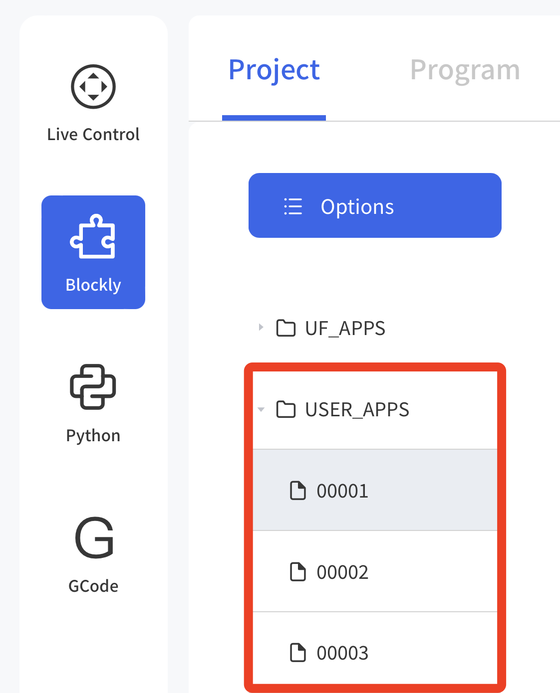

Blockly Programming - File Name ​
Feature Description
  • Added sorting logic for file names. For example, if projects are created in the order 003, 002, 001, they will be displayed as shown below.

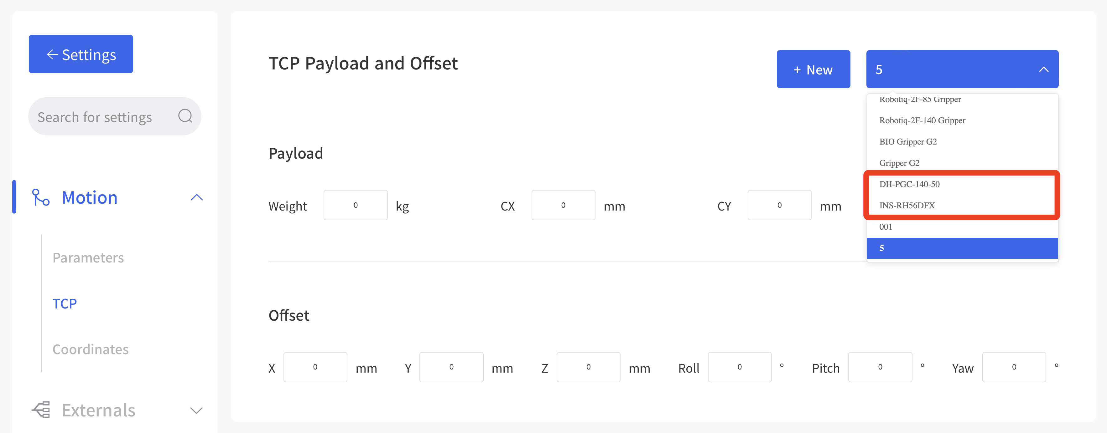

Settings - Motions - TCP ​
Feature Description
  • Added TCP payload and offset parameters for RH56DFX and DH-PGC-140-50 gripper.

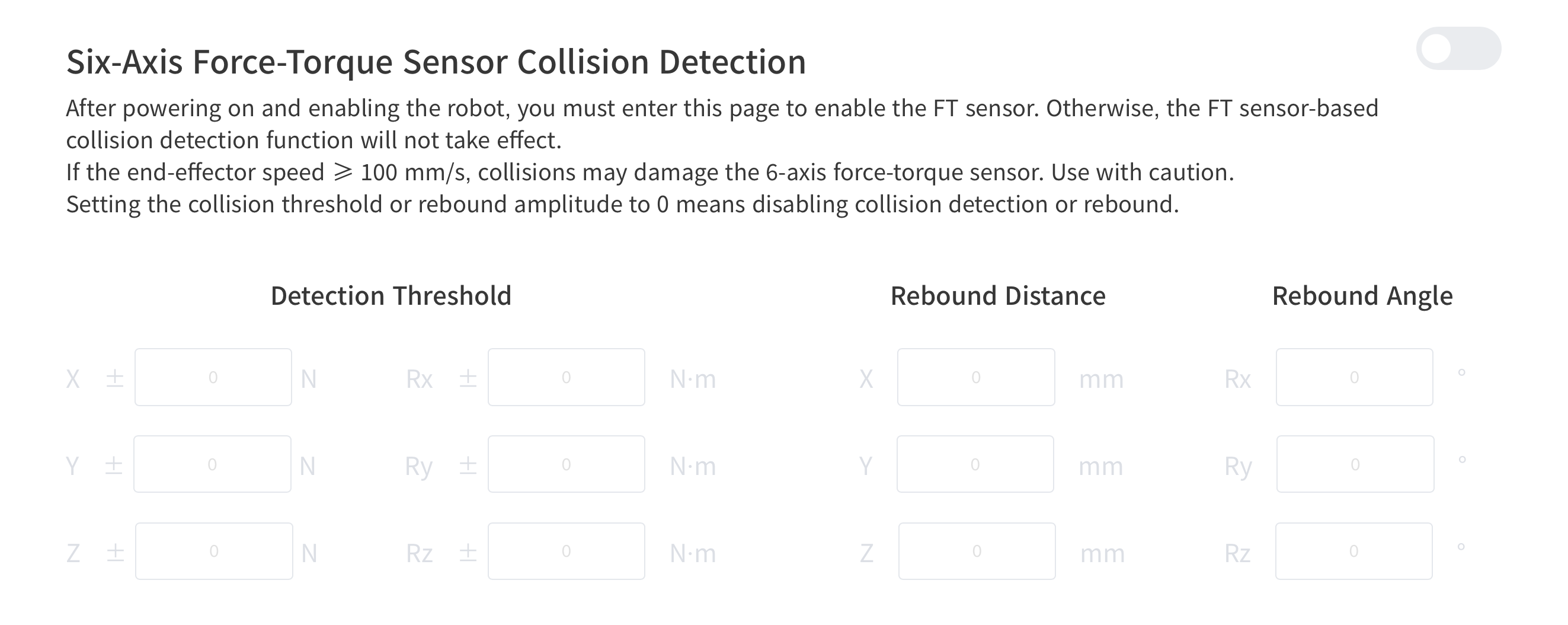

Settings - Externals - Torque Sensor ​
Feature Description
  • Added torque sensor collision detection.
  • Configurable parameters: Detection Threshold, Rebound Distance, Rebound Angle.
  • When the end speed ≥100mm/s, the sensor may be damaged by collision. Please enable with caution.

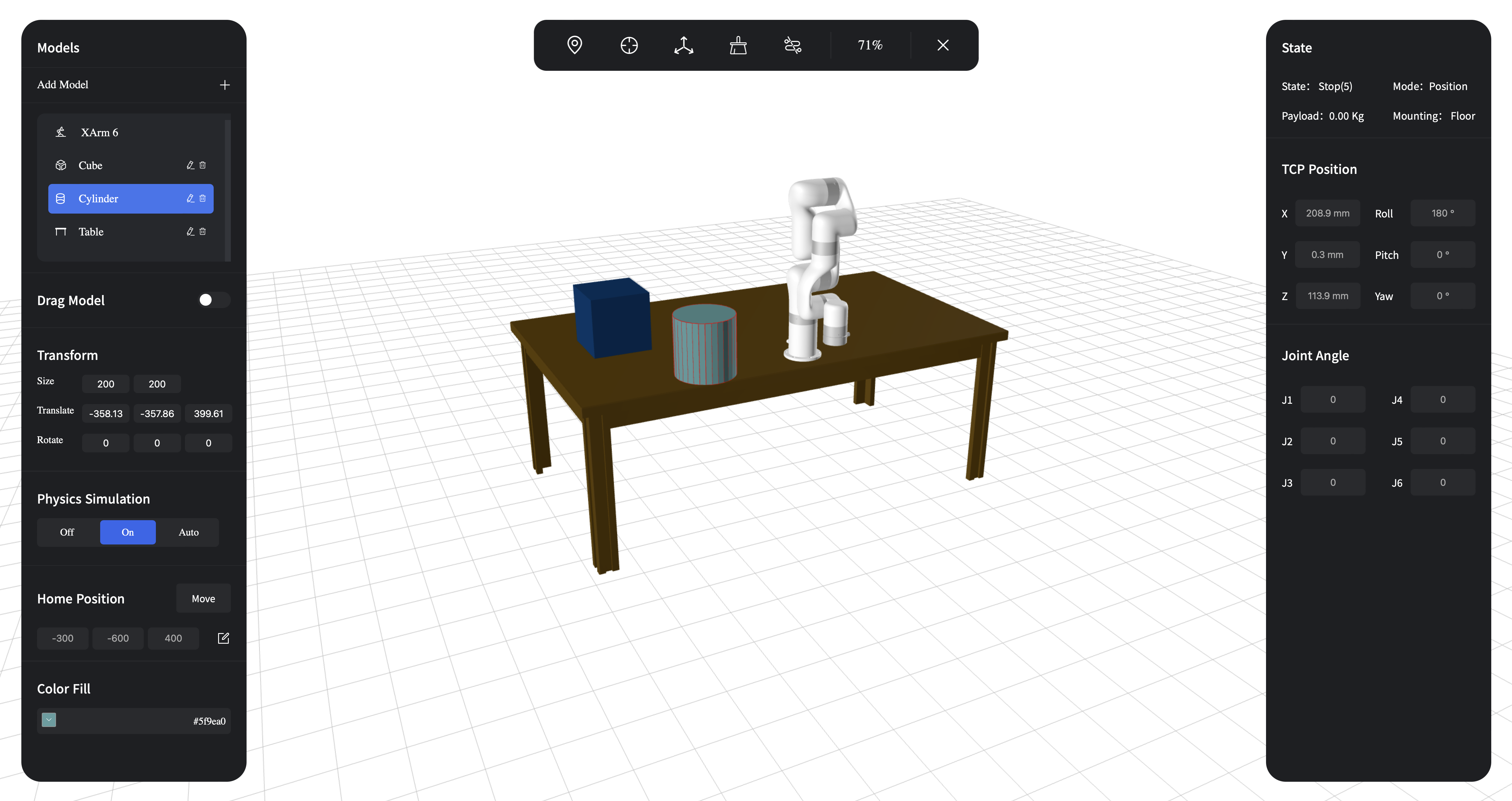

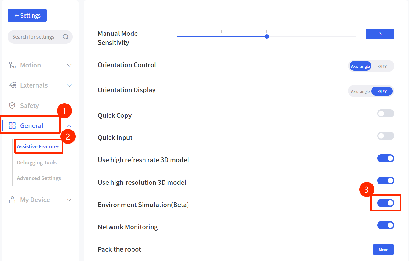

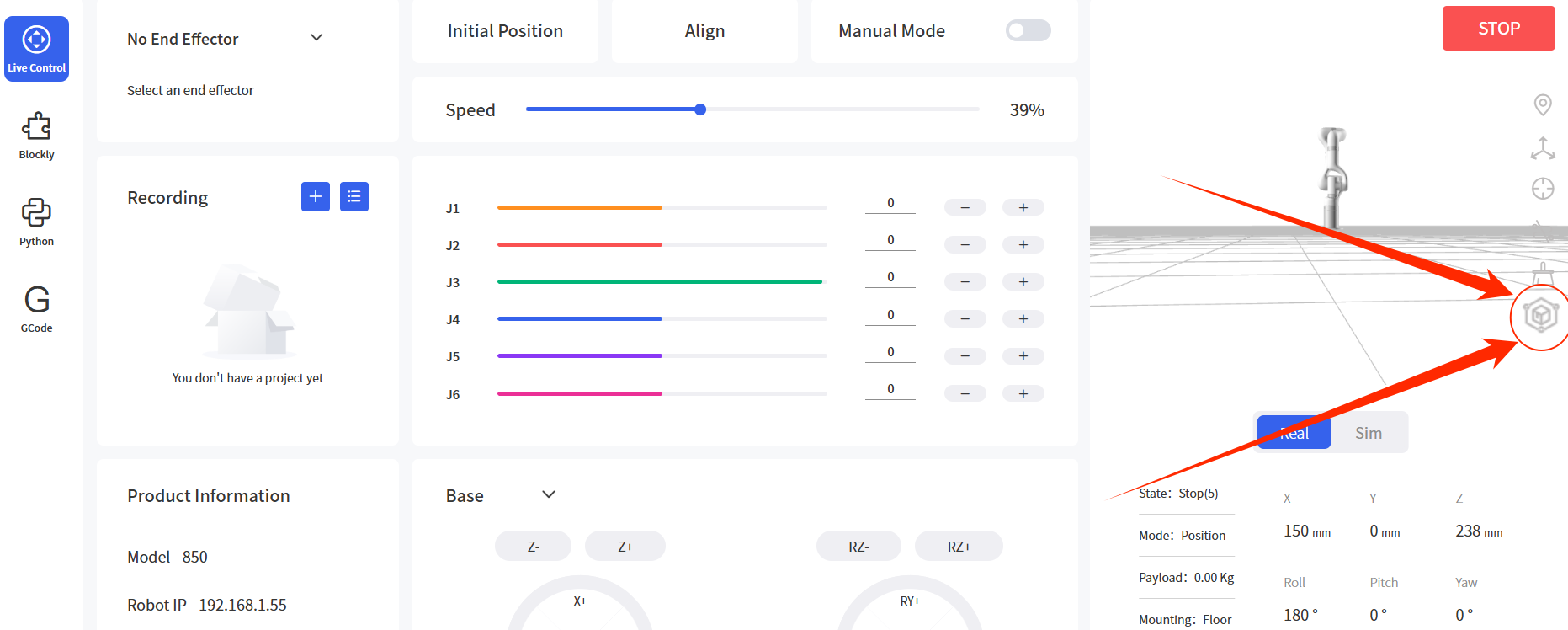

Settings - Assistive Features - Environment Simulation (Beta) ​
Feature Description
  • Enable the environment simulation option in Settings - General. (This feature is still in testing)
    2.7.0_setting
    2.7.0_environment_beta_3

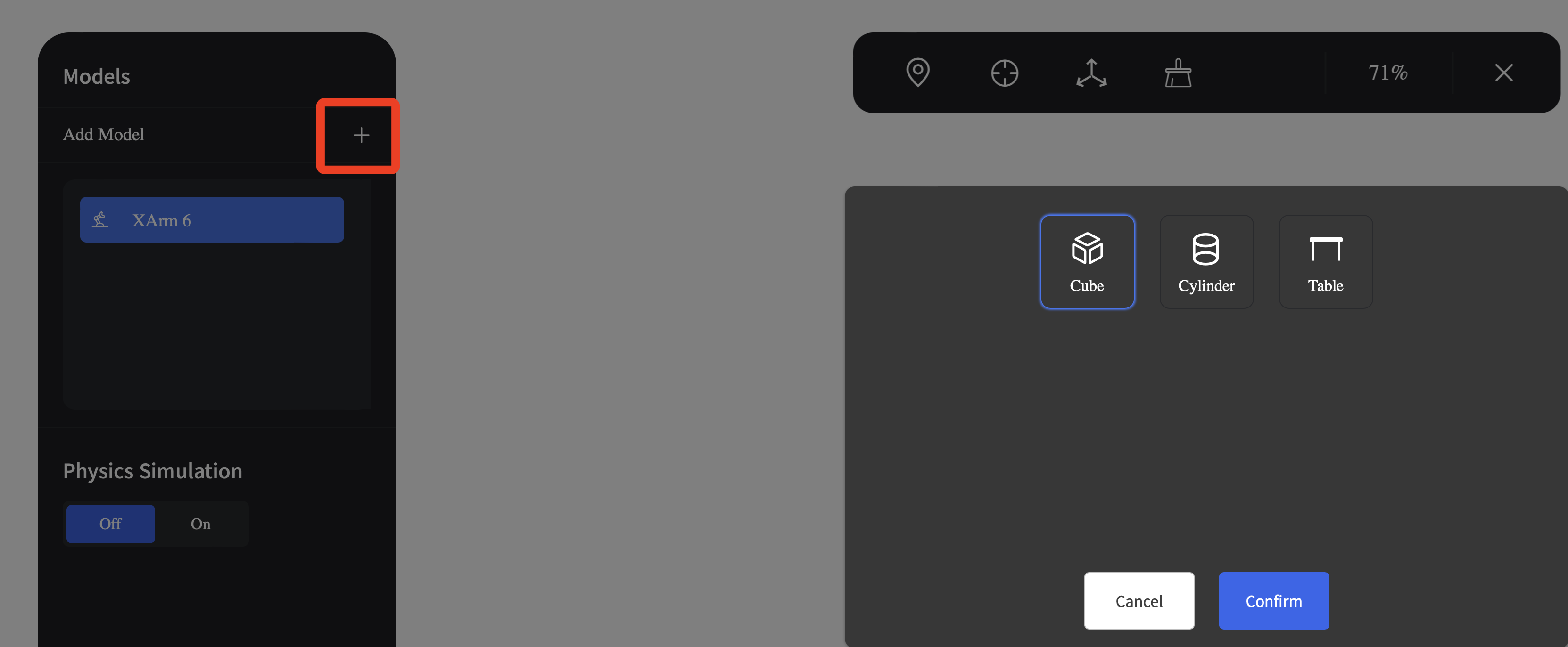

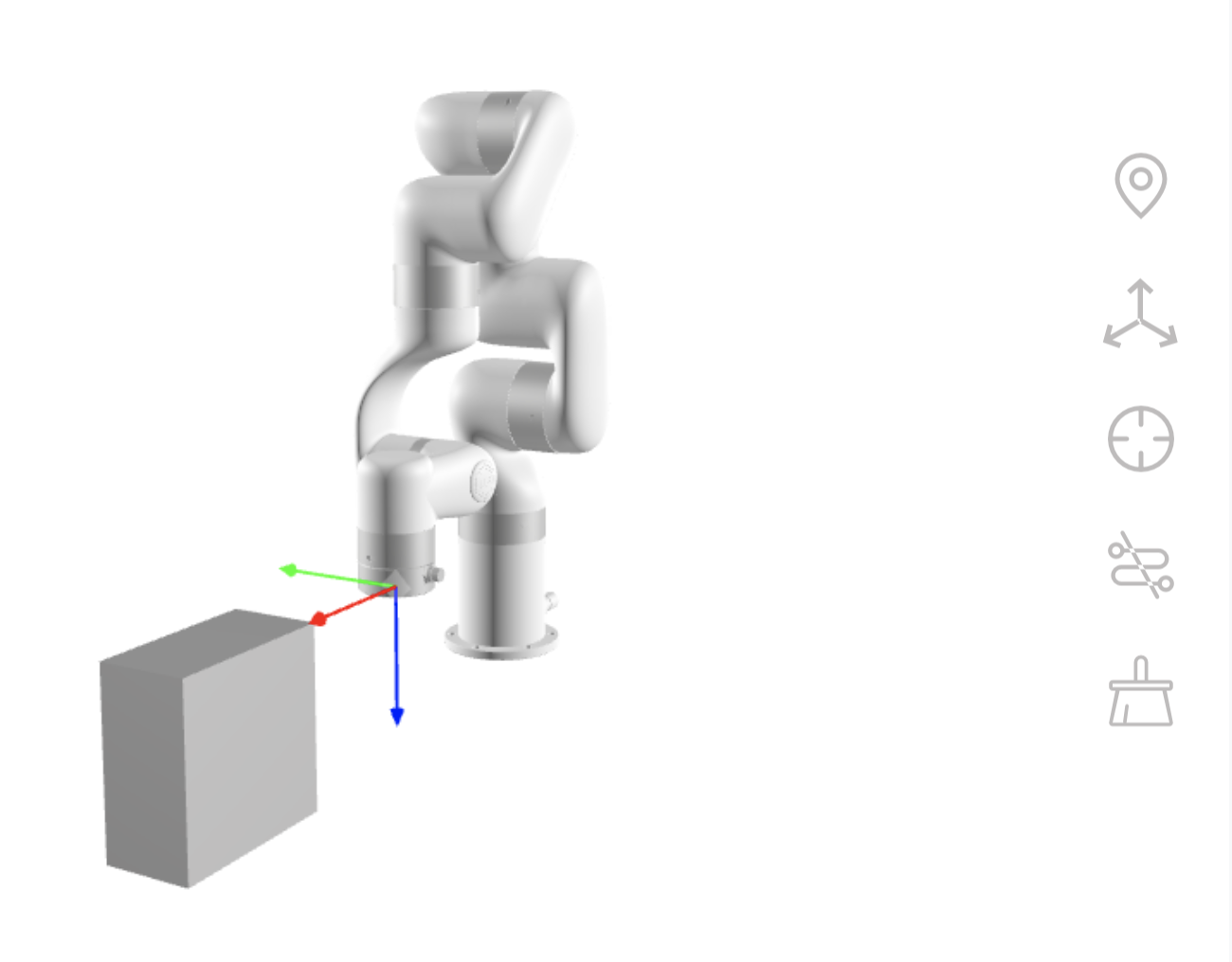

  • You can add models into the environment: cube, cylinder, table.
  • After selecting a model, you can enable drag mode to move the model to the desired position. You can also enable physics simulation to consider real gravity and collision.
  • If a collision occurs, the software will pop up a warning message, as shown below:
